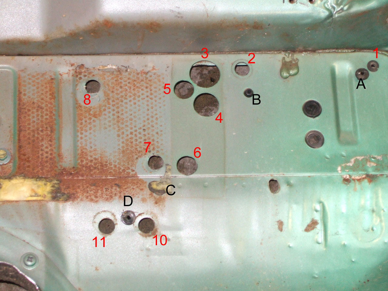

Here is a image of my 70 before I added the AC. I have labeled the 3 existing holes that will be of the most use to locate to: A, B, C.
I have also labeled the new holes 1-11 and a general idea of where they go. Here is the factory box labeled with the same numbers. 3-11. 1 & 2 are holes for vacuum lines and cables.
If you make a template off the box, you should be able to get really close to the factory location. If you are off a 1/4" or so, shouldn't be a big deal. Here is a shot with it installed and labeled. Unfortunately I had already coated the firewall and it was a last minute decision to add the AC, but I had a firewall to copy. So if you line #1 up just to the side and up from A, and 2 directly above B, and 7 above C, and 10 & 11 either side of D, you should be just about right!

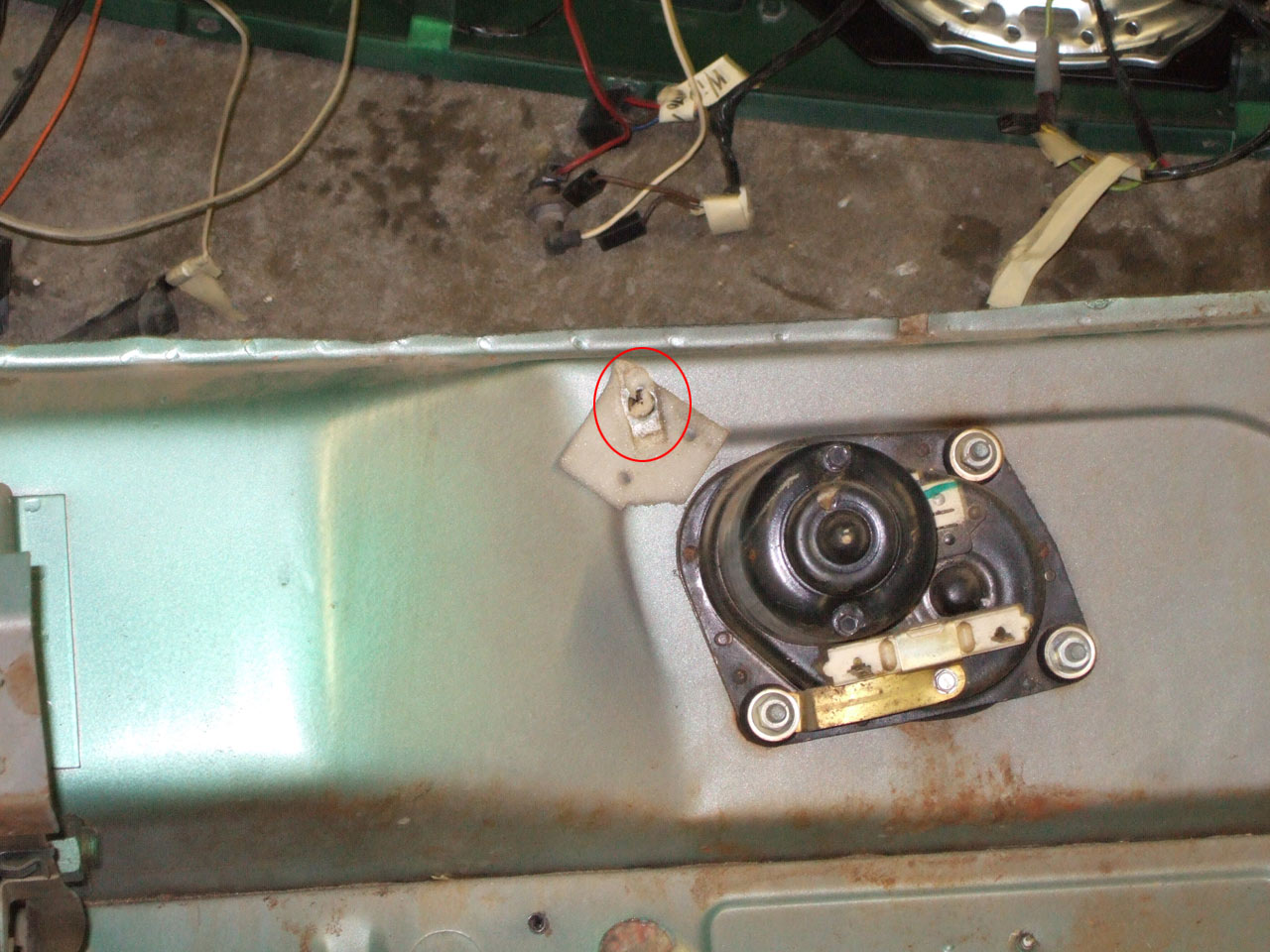

Here is a shot from the inside. Also, I just remembered there are 3 more holes for support braces in the cowl.
These I just installed the brackets and drilled the holes where they fell.
The Factory AC box requires 11 new holes, so trying to measure them will be hard. However you could make a template off the box its self and then eyeball the location to the firewall. There are a couple existing holes that can be used to get real close.

Forgot to mention:
1 is cable for water valve
2 is vacuum lines
3 & 4 are AC lines
5 & 6 are water lines
7, 8 & 9 are mounting studs
10 & 11 are drain lines
2 is vacuum lines
3 & 4 are AC lines
