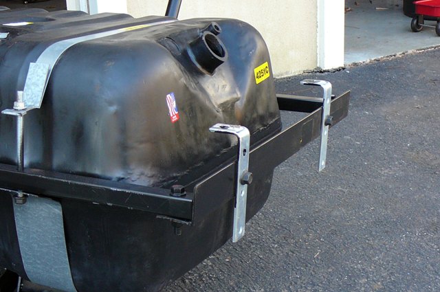

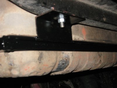

Here's some pictures. The front and rear cross pieces are 1" angle and the sides are 1" box tube. This is mainly because that is what I had laying around. The front and rear mounts are 2" strap and angle, respectively.
Here you can see how low it hangs in reference to the spring hanger

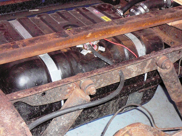

In this picture, the 2x4 above the tank is the height of the bed floor, so you can see about how high up in the frame I set the tank.

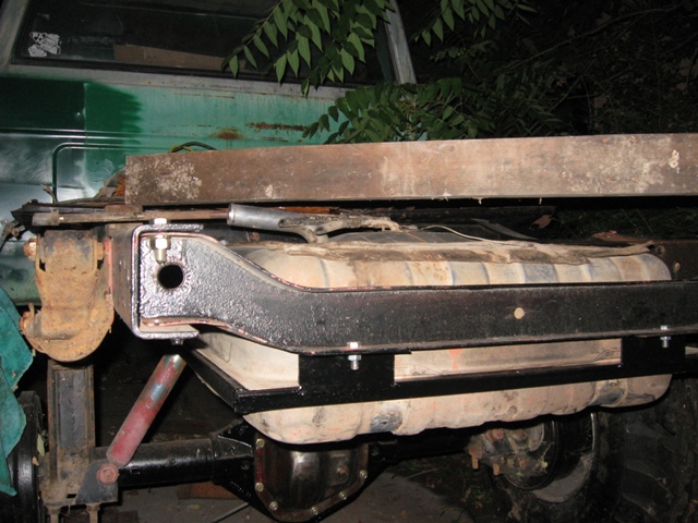

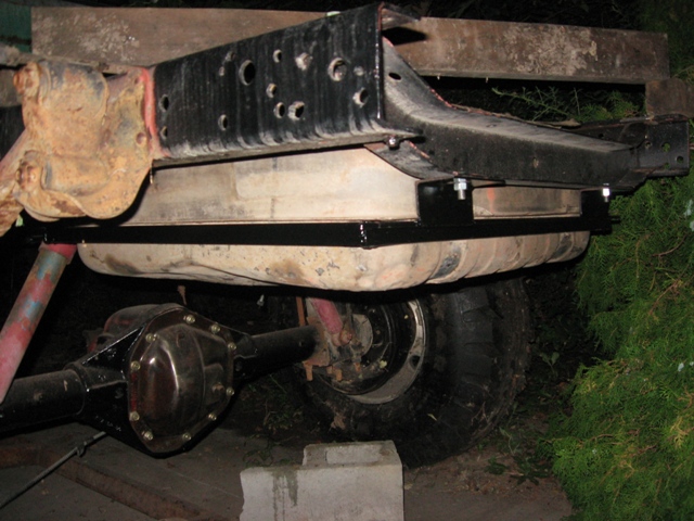

Rear angle iron and flipped crossmember. Bolts are Stainless Steel.

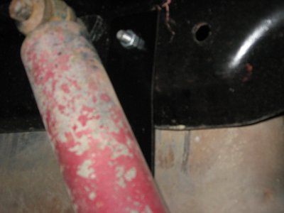

Front Strap mount. There was a divot in the crossmember that I just drilled out.
