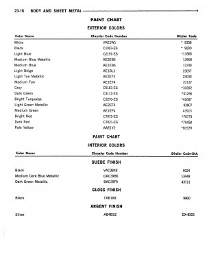

Lt Green Poly? That means the color has a bit of "flake" in it which is the "Metallic" color. If the description does NOT say Poly then the color is solid and has no Metallic in it. Here is a color chart for the 1970 truck. The Chev. section that was above the Dodge, I cut off for here to make the Dodge part bigger. So the Light Green Poly code for PPG paint is 2222 and when ordering paint, you MUST say that this code is from a PPG chart. You'll have to make sure that is the color you are actually looking for.

This page is from the 1969 - 1971 Dodge Truck Factory Service Manual:

Re: 1970 W100 paint question
The service manual lists 43807 as the Ditzler code for light green metallic. Utilizing the link Bucky posted, search for "43807" in it's search box. It'll return a result for a Dodge truck application. Now, at the far left of that result there will be a column labeled image, with three link letters. Each of these letters represents a search engine (Bing, Yahoo, Google) clicking each of them will return images with that paint color. So you can see a photo of a truck actually painted in that color, rather than looking at a chip.
